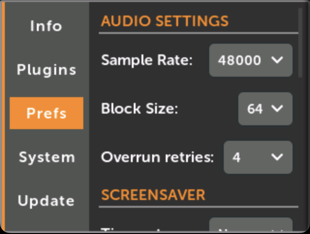

Preferences
  • 1. Click Settings in the Main Menu
Main Menu
  • 2. Click Prefs
Prefs

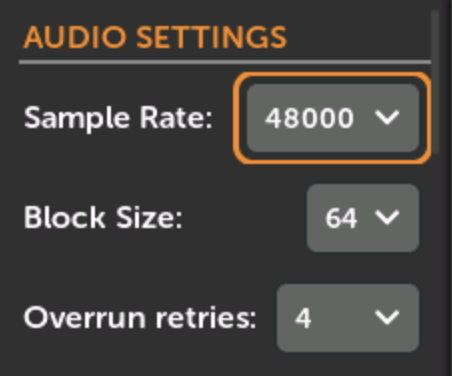

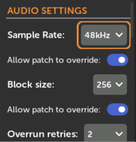

  • Audio Settings
    Sample Rate: 24000, 36000, 48000, or 96000. Higher values are generally better quality but use more CPU.
    Block Size: 16, 32, 64, 128, 256, 512. Lower values result in less latency. Some modules may only work with higher values. Sometimes higher values are more efficient, using less CPU (varies per module and patch).
    Allow patch to override: (Sample Rate and/or Block Size). Checking this allows patches to change the sample rate and/or block size when the patch is loaded. You can view or set a patch's suggested audio settings in the Info icon of the Patch View page (see Patch Info), or from VCV Rack when creating the patch (see Setting Suggested Audio Settings). If a patch is currently overriding the audio settings, then that will be displayed here in orange text. In that case, turning off the override preference will restore the default audio setting.
    Overrun Retries: If a patch takes too long to render a block of audio, there will be an audio glitch. This setting selects the number of audio glitches you're willing to tolerate in a one second period before the patch is stopped.
    Auto Re-balance: Selects if the MetaModule automatically searches for a better way to divide a patch's modules between its two processor cores. Off never does this automatically. After Overload (the default) does it when you re-start a patch that was stopped for overloading the CPU. Every Patch Load does it each time a patch is loaded and played. The audio is silent for about a second while the search runs. See CPU Load Balancing.
Audio Settings

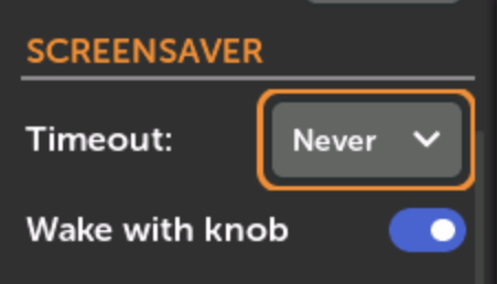

  • Screensaver
    The screen will turn black if no controls are moved for a specified amount of time. The audio will not be changed. Signals on the jacks and MIDI will not wake the screen up.
    Optionally, you can enable or disable if turning knobs will wake the screen up.
Screensaver Prefs

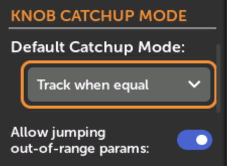

  • Knob Catchup Mode
    When you load a patch or change Knob Sets, the physical knobs might not be in the same position as the virtual knobs they're mapped to. Each Knob Catchup Mode does something different to handle this situation:
    • Track if knob moves: This jumps the virtual knob's value as soon as you turn the physical knob.
    • Track when equal: The virtual knob will start tracking the physical knob when they are equal.
    • Linear Fade: The virtual knob will always change in the same direction as you turn the physical knob, but it might be larger or smaller amounts.
Knob Catchup Mode Prefs
In Track when equal mode, there is an additional option to allow jumping out-of-range parameters. This is a rare situation that can occur if a knob or switch is mapped in two different knob sets with different min/max ranges, or is manually adjusted outside of the mapping's min/max range. If the virtual knob's value is set to a position that's outside of the min/max range of the current knob set, then checking this option will allow the virtual knob to start tracking when the physical knob is moved as close as possible. Otherwise if this is not checked, the virtual knob will not be accessible from the current Knob Set. If you are unsure, we recommend checking this option.

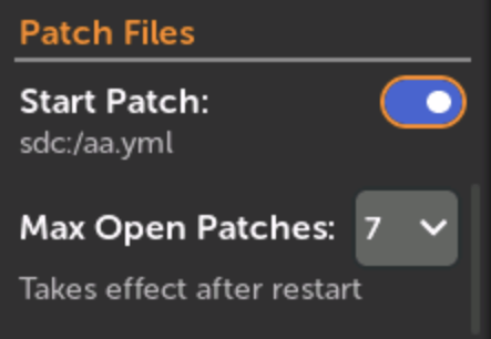

  • Patch File
    Startup Patch: the patch that's played when the module first starts up. If this checkbox is checked then the patch shown below will be played. You can change the Startup Patch by going to a patch and selecting "Startup Patch" in the File menu. See Patch File Menu
    Max Open Patches: The maximum number of patches that are allowed to be open at one time. Opening additional patches will automatically close the oldest patch that doesn't have unsaved changes. If all open patches have unsaved changes then a warning will pop up, asking you to close some patches.
Patch File Prefs

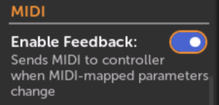

  • MIDI Feedback
    MIDI Feedback sends the value of MIDI-mapped knobs back to the MIDI controller. This allows the controller to stay in sync with the patch when you load patches, change knob sets, and when modules change their own parameter values (for example loading a scale preset on a module).
    Enabling this is usually safe, but if you notice strange behavior from your MIDI controller, try disabling this.
    See MIDI Feedback
MIDI Prefs

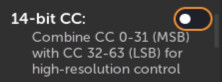

  • MIDI 14-bit CC
    14-bit CC enables receiving 14-bit CC messages. CC 0-31 are used as the MSB and are paired with the CC number 32 higher for the LSB (CC 32-63)
    When enabled, mappings from CC numbers 32-63 will be ignored. Any CC messages received in this range will by combined with the corresponding CC number 32 lower.
    See 14-bit CC
MIDI 14-bit CC

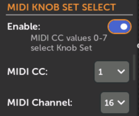

  • MIDI Knob Set Select
    MIDI Knob Set Select lets you change the active Knob Set with a single MIDI CC message. When enabled, choose a MIDI Channel and CC# — sending a value of 0–7 on that channel and CC# will immediately switch to the 1st through 8th Knob Set (CC value 0 → Knob Set 1, 1 → Knob Set 2, …, 7 → Knob Set 8).
    See MIDI CC Knob Set switching

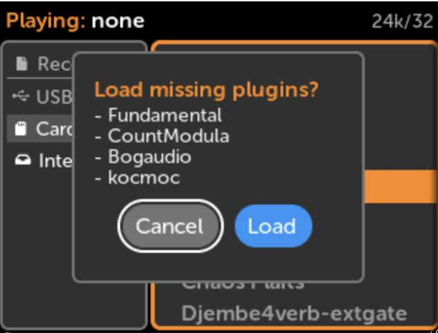

  • Missing Plugins
    Search for missing plugins: This determines what happens when you open or reload a patch that uses modules that aren't installed. The selected behavior will happen when a patch is opened, when it's refreshed via Wi-Fi or disk, or when you choose "Reload" or "Revert" from the file menu.
    • Ask: List the missing modules, and ask permission to search all disks for plugins that contain those modules and then load them.
    • Always: Immediately search all disks for plugins that may contain the missing modules, and then load those plugins.
    • Never: Ignore missing modules
    If a search and load happens and there are still missing modules afterwards, the list of missing modules will be displayed.
    See Auto-loading plugins
Missing Plugins Prefs Ask Missing Plugins

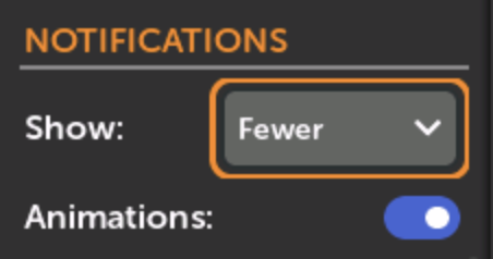

  • Notifications
    Notifications are pop-up messages that appear briefly on the screen to confirm actions, warn about errors, and report status. If you find them distracting, you can reduce how many you see:
    Show:
    • All: show every notification (default).
    • Fewer: hide routine status notifications. Errors and important messages are still shown.
    • Critical: only show errors and messages that must be acknowledged (for example: a file failed to save, or a patch has unsaved changes and cannot be updated).
    Animations: when off, notifications appear and disappear instantly instead of using the dropdown animation. Turn this off if the animation feels slow or distracting.
Notifications Prefs
