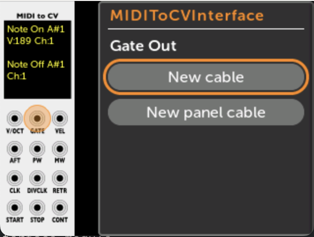

  • 1. Click on a jack, and click New Cable
    You can start a cable from the input or output. If the jack is already patched, then the new cable will "stack" on top of the existing cable (thus acting like a passive mult)
    If this is the first cable you're creating this session, a pop-up will remind you of how to patch a cable. Read it and click OK.
New cable start

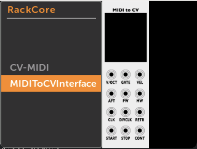

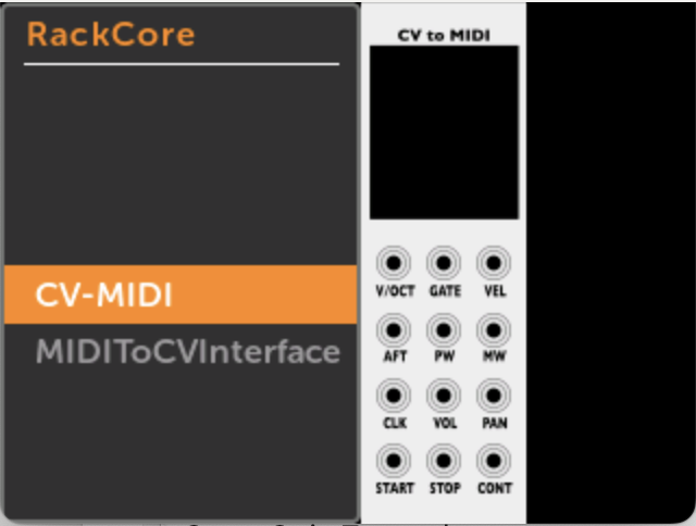

  • 2. Navigate to the jack you want to connect to
    • Find the module you want to patch to, and click on it.
    • Then scroll to the jack you want to patch to, and click on it.

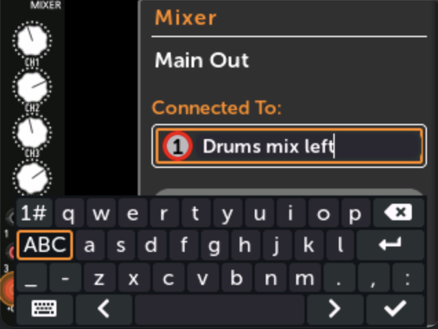

Creating or editing a Jack Alias
You can provide a custom name for a panel jack mapping.
  • Create or edit an alias
    Click on the jack, then click on the panel jack mapping in the "Connected To:" box.
    Jack aliases are saved with the patch, and are shown on the Jacks page.
Edit Jack Mapping
You can also create and edit jack aliases in VCV Rack in the context menu for the MetaModule.
