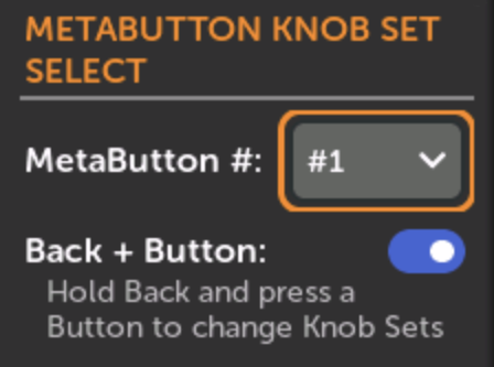

Using MetaButtons to change Knob Sets
You can configure a MetaButtons expander so that pressing Button 1 jumps to Knob Set 1, Button 2 to Knob Set 2, and so on up to Button 8 → Knob Set 8. If the patch doesn't have the requested Knob Set, the button acts normally (press and release events are passed through to the module it's mapped to).
The behavior is set in Settings > Prefs: MetaButtons as Knob Set selector
MetaButtons # selection:
  • Off: buttons never change Knob Sets (default).
  • Any: any MetaButtons expander can change Knob Sets.
  • #1 / #2 / #3 / #4: only the designated MetaButtons expander changes Knob Sets. The other expanders continue to work as normal.
Back + Expander Button mode
Optionally, you can require holding the Back button while pressing an expander button in order to switch Knob Sets. This mirrors the Back + encoder turn shortcut on the MetaModule and lets you use the same buttons for both normal mappings and Knob Set navigation in the same patch.
When this mode is on, Back events are suppressed on button release so the Back button doesn't also navigate away from the current page.
Mapping buttons alongside Knob Set navigation
If Back + Expander Button is off and you map a button that is also configured to select a Knob Set, it's unpredictable whether the button event fires against the old or new Knob Set's mappings. Turn on Back + Expander Button mode if you want to use button mappings and button-based Knob Set navigation in the same patch.

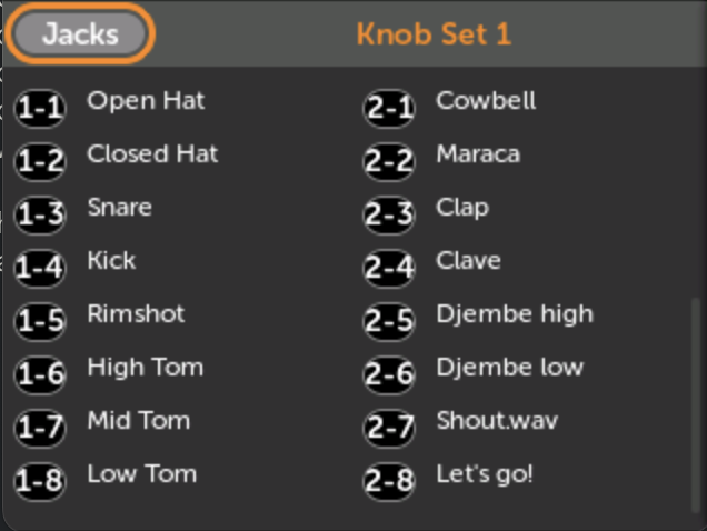

Button names
Buttons are named by the MetaButtons module number (1-4), followed by the button number (1-8). For example, if you just have one MetaButtons module then with the jumper in the default position, the first button is Button 1-1 (or B1-1 for short). The second button is Button 1-2, the third is B1-3, etc.
If you daisy chain two MetaButtons modules, and set the jumper on the second one to position 2, then the buttons on the second module will be B2-1, B2-2, B2-3, etc. (See below for information about the jumper positions)

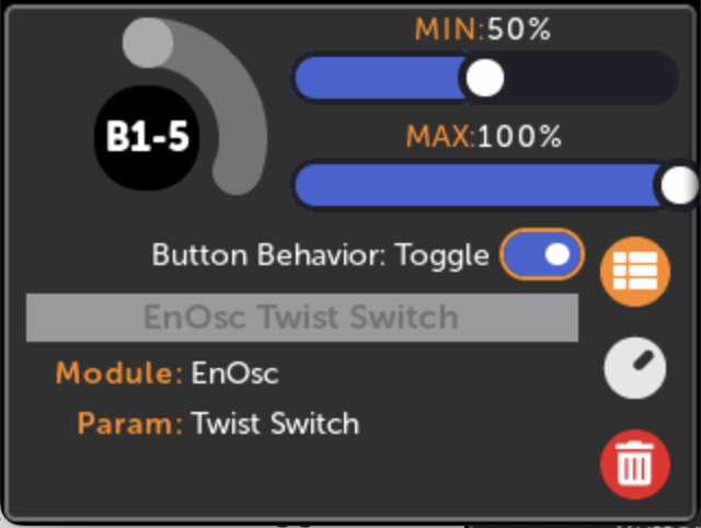

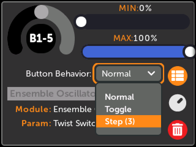

Each button map has a Button Behavior setting that chooses what happens when you press the button. To change it, open the Knob Sets page (see Viewing button maps) and click on the button map.
  • Choose Normal, Toggle, or Step
    • Normal: The parameter is set to the Max value while the button is held down, and to the Min value when it's released.
    • Toggle: Each press alternates the parameter between the Min and Max values.
    • Step: Each press moves the parameter to its next position. After the last position, it starts over at the first.
Button Behavior
Step mode is meant for controls that have more than two positions, such as a three-way switch, a rotary selector, or a slider with a fixed number of stops. The number of positions is shown next to it in the menu: for example Step (3) for a three-position switch. Step is the default for a new button map on a control like this, so pressing the button walks through all of the switch's positions.
The Min and Max values limit the range in all three modes:
  • In Toggle mode, they are the two values that the button alternates between. For example, you can toggle between the middle and top positions of a three-position switch by setting Min to 50% and Max to 100%.
  • In Step mode, the button only steps through the positions between Min and Max. For example, on a six-position selector you can step through just the first three positions by setting Max to 40%.
  • If Max is less than Min, Step mode steps through the positions in the opposite direction.
If a control doesn't have a fixed number of positions (an ordinary knob, for example), Step mode does the same thing as Toggle mode.
Viewing button maps
Button maps are shown below knob maps.
  • 1. Open the Knob Sets page
Knob Sets icon
  • 2. Scroll down past the knobs to see the button maps
Knob Sets icon

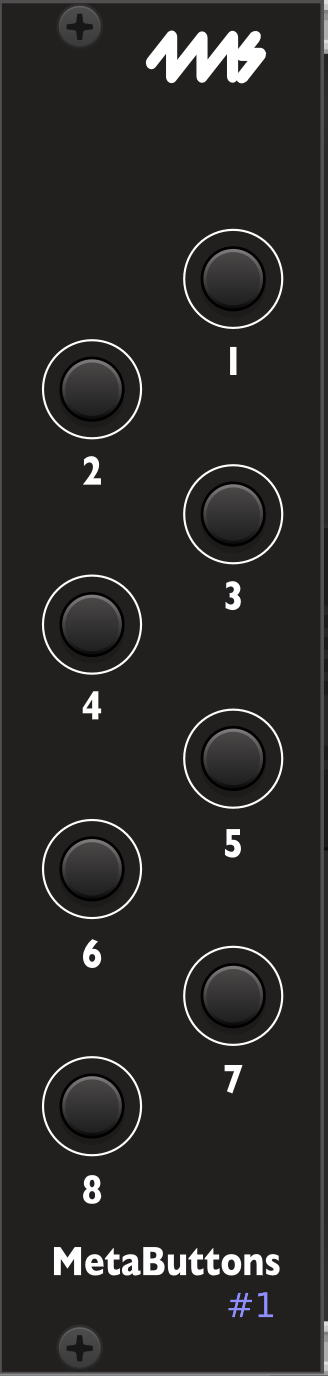

  • 1. Add a MetaButtons module to your patch
    Make sure the number in the bottom corner matches the jumper installed on the back of your module. If not, click it until it does.

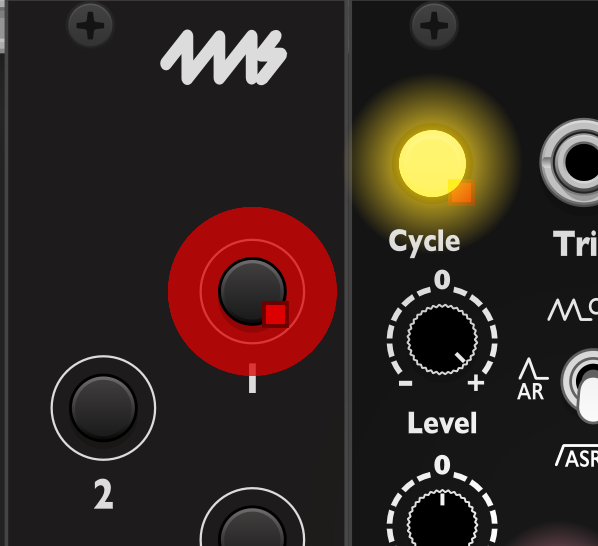

  • 2. Click the mapping ring around the button, then click a virtual parameter to map to
MetaButtons VCV

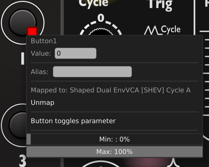

  • 3. Right-click the button to change the Button Behavior
    Choose Normal, Toggle, or Step from the Button Behavior menu. See Editing a button map for what each one does.
    The Min and Max settings control the range of values that the button toggles or steps through.
    You can also set an alias name for this mapping

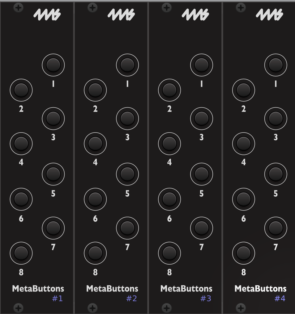

  • 4. To use more than one MetaButtons, give each one a unique number (1-4)
    Click the number to change it.
    The numbers will be red if there is a conflict.
MetaButtons VCV
