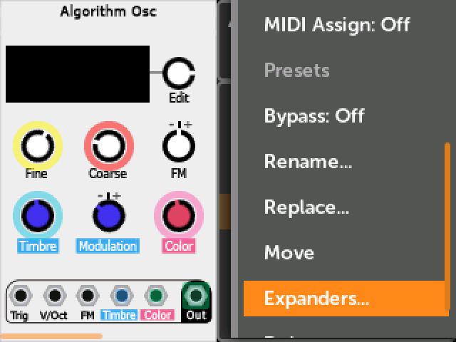

Module Action Menu
The Module Action Menu is found by clicking on a module in a patch and then clicking on the Tool icon at the top.

Presets
Clicking this will let you browse all factory presets for the module. If no presets are found, then this option will be disabled.
Note that in the current MetaModule firmware, loading user-created presets is not supported. Users who are familiar with the command line could add a preset to a plugin file like this:
tar -xf PluginName.mmplugin
cp 01_my_preset.vcvm PluginName/presets/ModuleName/
tar -cf PluginName.mmplugin PluginName/
MIDI Assign
This enables MIDI Assign mode, which allows you to quickly map parameters to MIDI CC or MIDI Note gate on/off events. See Quick Assign Jacks
Delete
Delete the module from the patch, removing all cables and mappings. This cannot be undone. (However, you can Revert the patch file to restore the module.)
